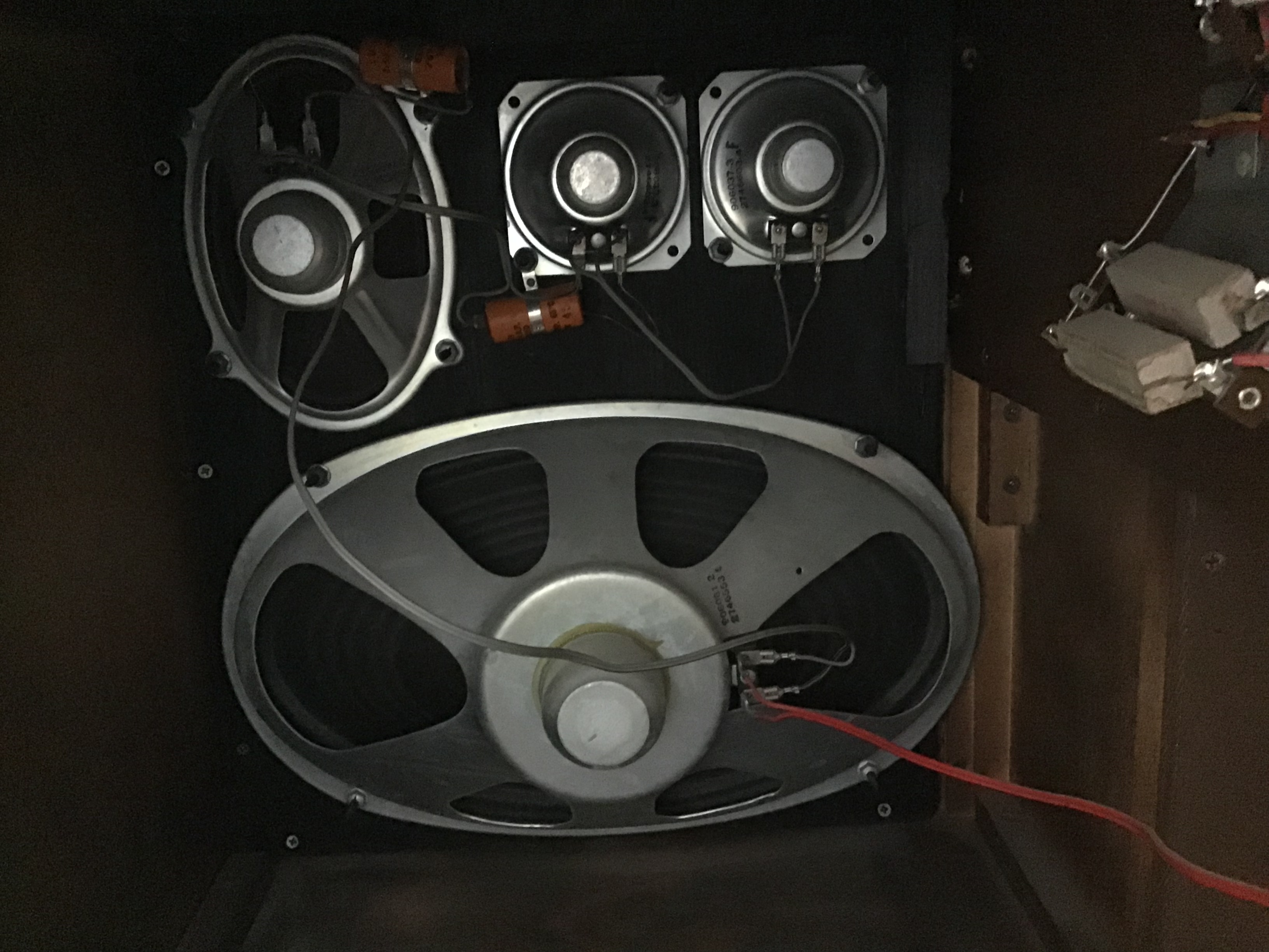

Trying to find information about my project.
It's a Solid State RCA Victor Model VGT90W console from 1965 ("G" designation?) with a S/N of 60 4130. It is a "New Vista" but I’m trying to identify the cabinet styles. Dimensions are 62.5” x 19.5” x 25” tall. I have stumbled on pics of consoles sharing the Tuner/TT layout but nothing that has the eight speaker layout (which another member states makes it a deluxe unit)
Everything powers up and functions and since this is my first foray into electronics repair I started with baby steps replacing only the two 1500 caps in the power supply. The unit still has the “hum” so I’m planning on diving in deeper and a complete cleaning/refurb of the TT.
Any additional information or tricks of the trade are appreciated.

Re: RCA Victor VGT-90W newbie restoration
Does it hum on all functions?... could be a flaky ground ... flip the power cord outlet plug , and see if that helps...
Finally tried the plug trick - no improvement.hermitcrab wrote: ↑Sat Sep 21, 2024 3:41 pm Does it hum on all functions?... could be a flaky ground ... flip the power cord outlet plug , and see if that helps...
I was able to identify the cabinet through on of the FB console groups I joined. Sorry for the poor quality pic but it's all I have. Was also able to obtain the correct Service Manuals from YouTube's Steve Scarlet.
Appreciate all the information and tips received.
- Posts: 9026
It is important to know whether the hum is there all the time. If so and if on all functions, you may need to look at the filter caps in the power supply.
Most likely the caps are dried up...but the power supply shows what looks like replacements already the hold down clamps are there but empty... it is definitely worth the time to re-cap it .. looks like one of RCA's better units

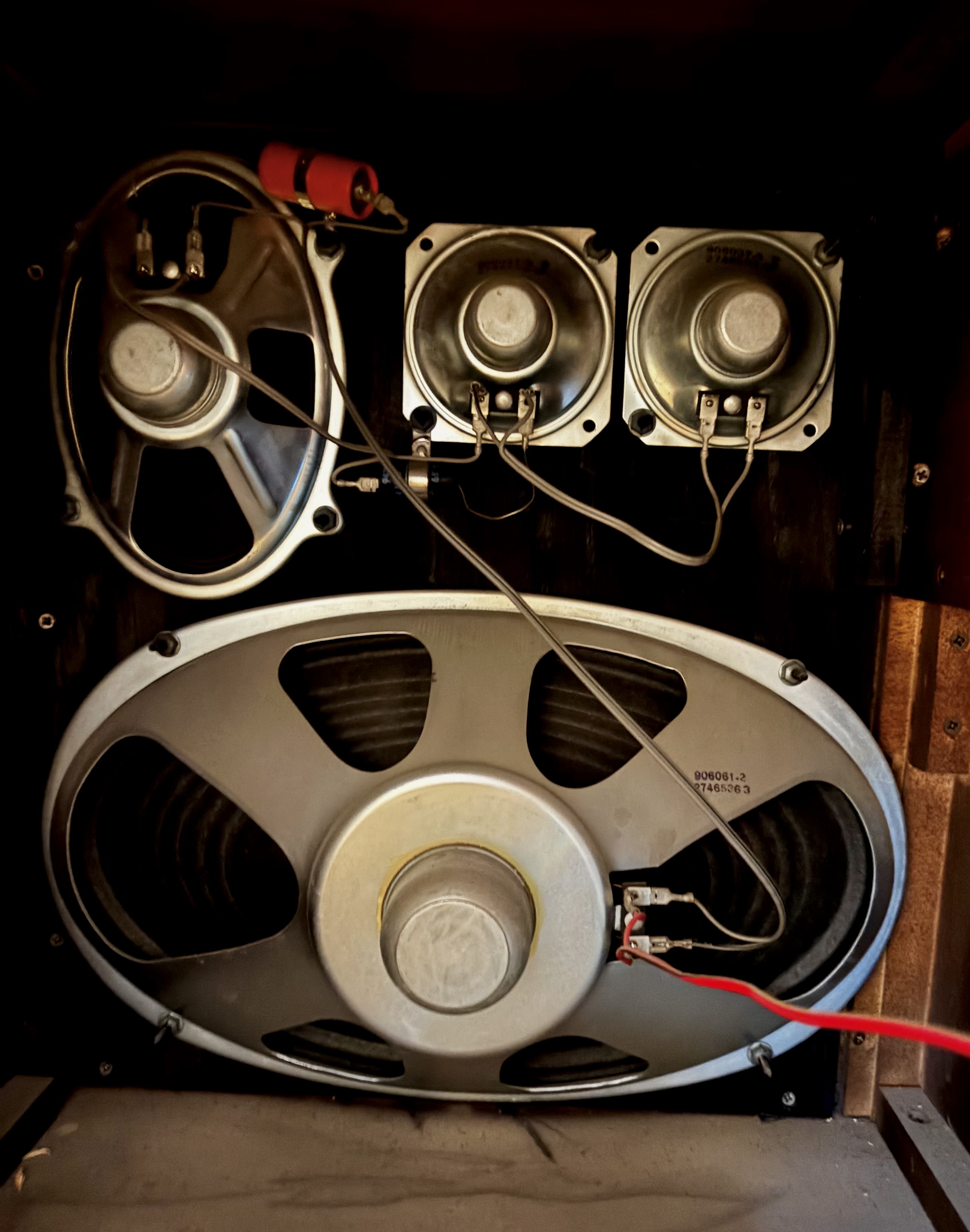

Hi
How is your restoration going?? I just acquired the exact same unit. Trying to decide a game plan. It was my wife’s grandparents. [image][image][/image][/image]
