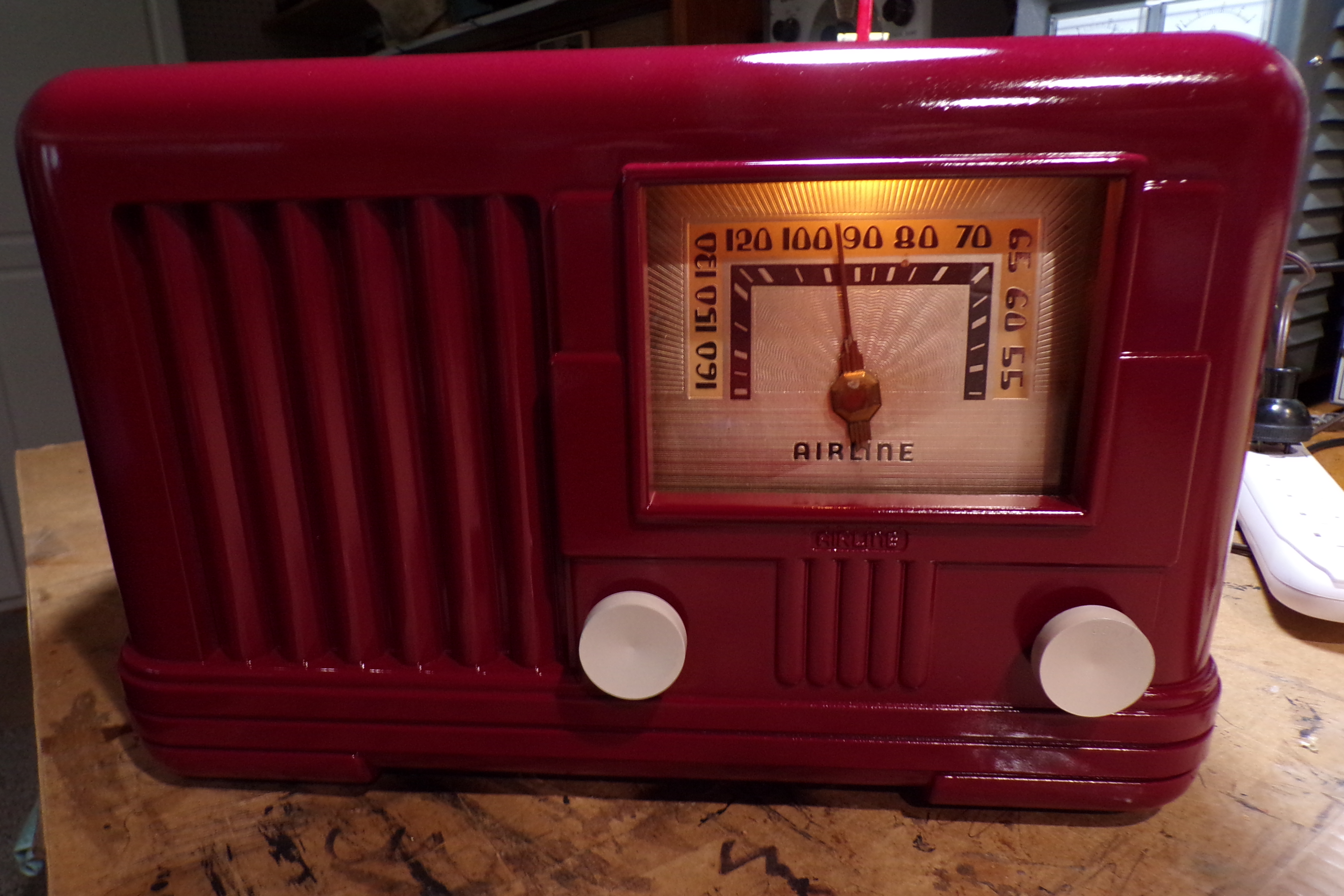

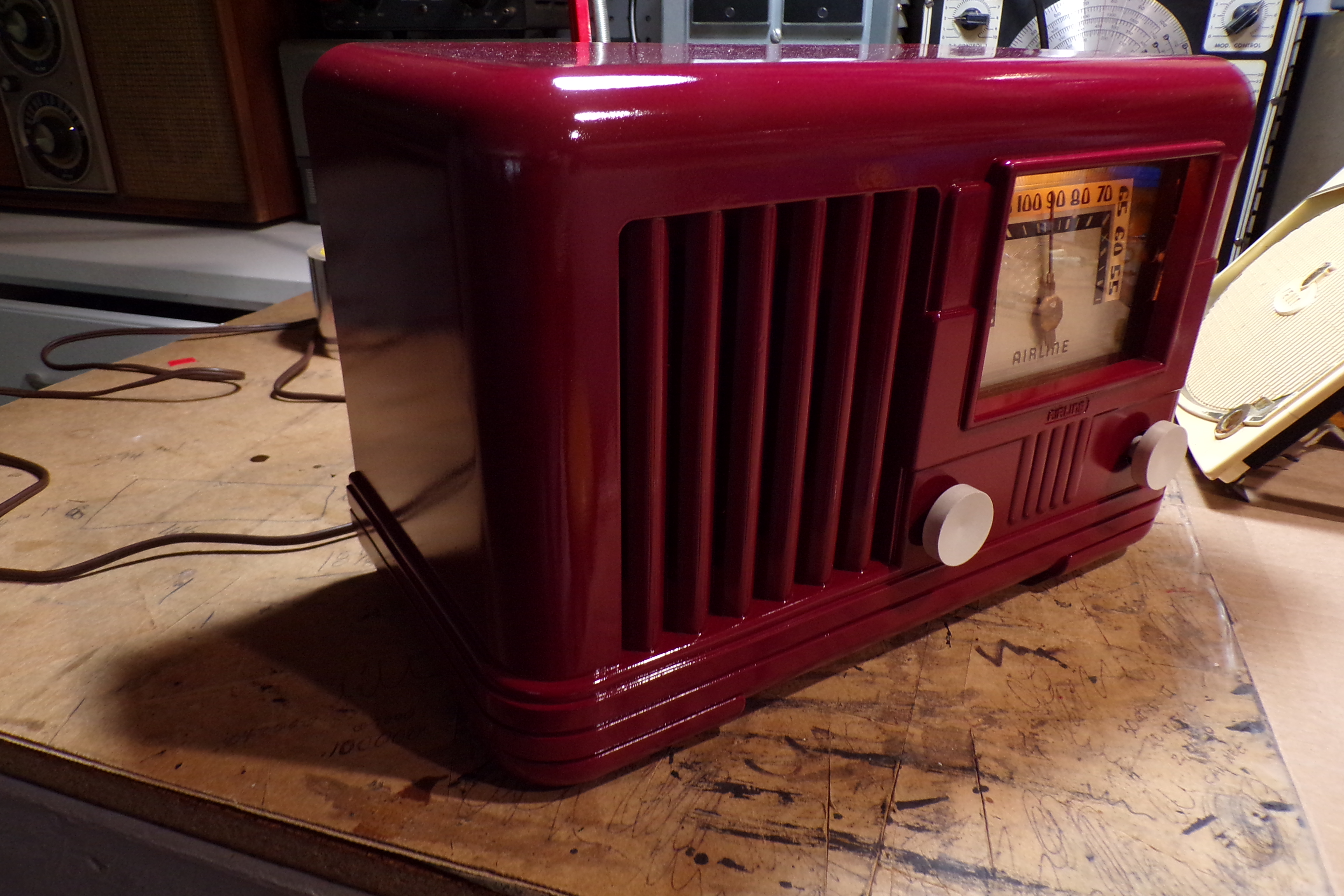

Post: # 23729Post electra225 »
It's done! I wanted to two-tone it, but the paint turned out so nice, I didn't want to press my luck.

Post: # 23744Post electra225 »
Thanks, Mr. Mogul! This radio has record player parts in it. I used the switch/volume control out of a junker record player chassis in this radio chassis. ;) ;)
This set didn't have the original knobs anymore and the ones there wouldn't work with the shorter volume control. The knobs I used are for a TV chassis. One knob says "horizontal" the other says "contrast". I filled the script best I could. Thank God for glazing putty....... ;) ;)
Another little tidbit of information on this set is that the backwards, weirdly-shaped dial is probably as accurate as any I own. The station it is on is 960 Khz, which is really close to where the pointer is.
