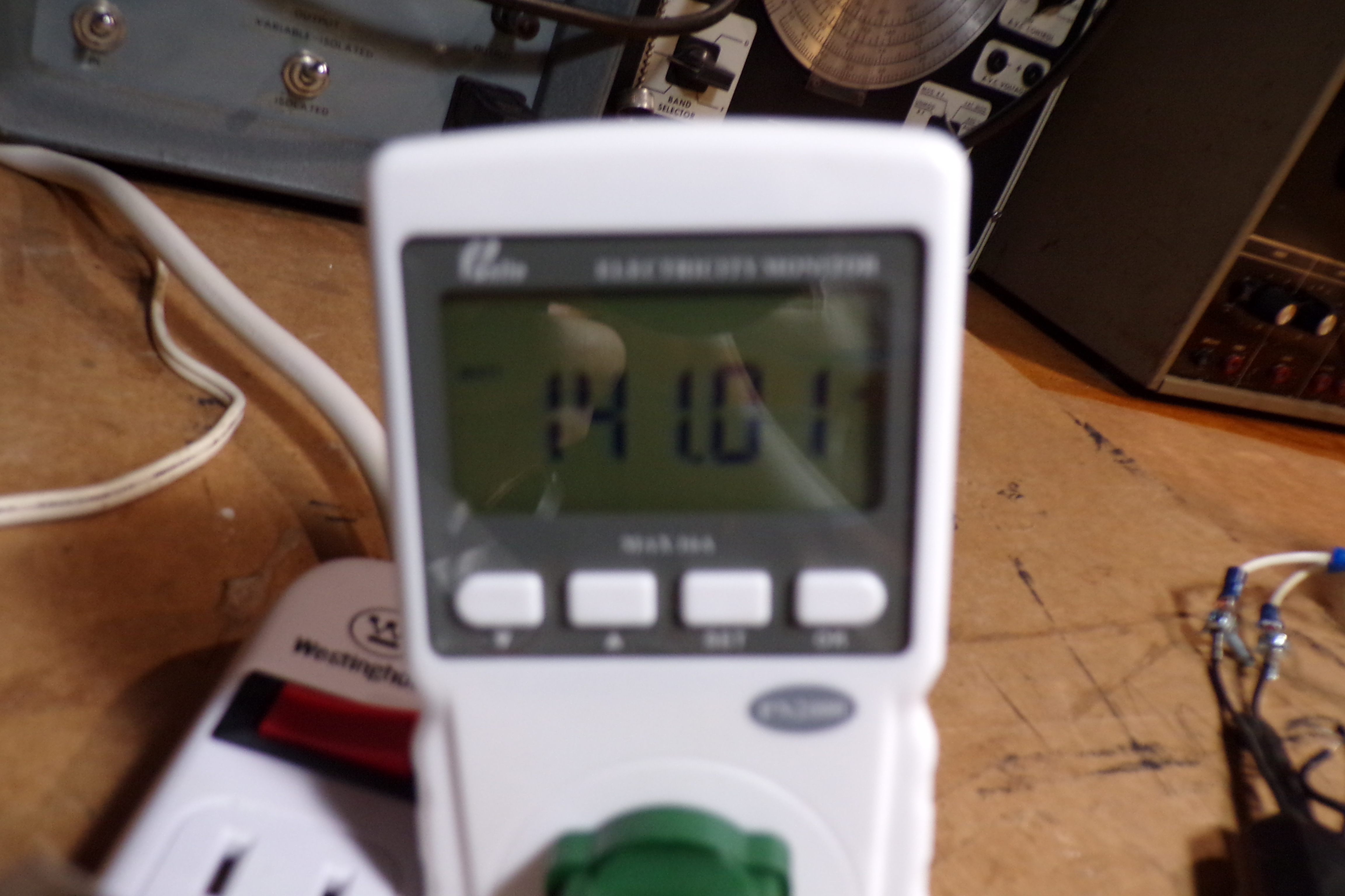

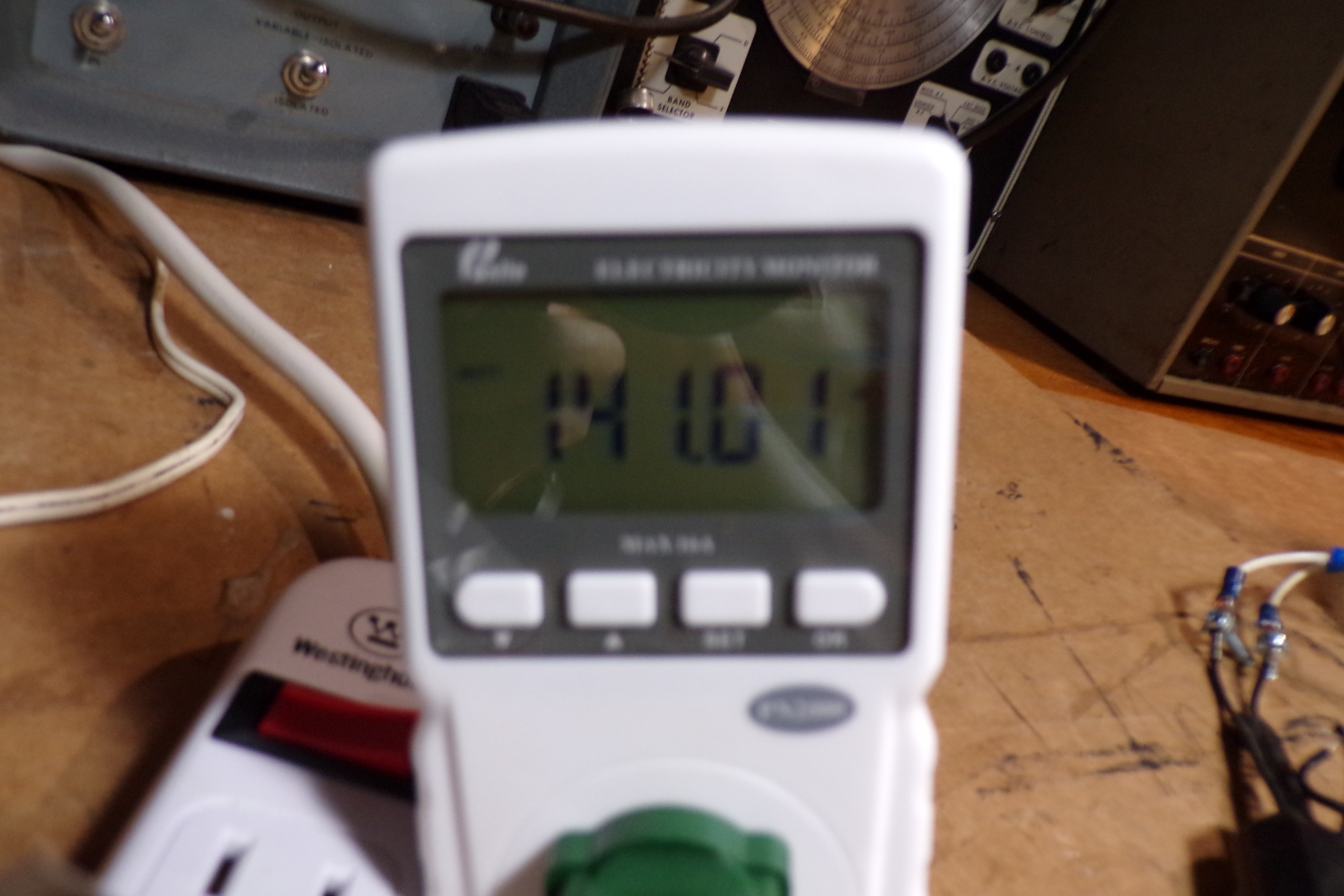

I pulled the plate cap off the horizontal output tube, connected the set to the Variac and KAW. I started out at about 40 volts, left it there for 30 minutes. Next was 65 volts, then 90, then 115, finally 120 VAC on the line. I have audio, I have hash from the speaker, indicating that the tuner is working. Very dirty, but working. It draws 124 watts at 120 VAC on the line with just the filaments, no high voltage. 13 tubes plus the picture tube. Keep in mind that at least three tubes are Compactrons. One tube is the vertical multivibrator and vertical output tube in one envelope. I still believe 124 watts on the filaments is excessive. The filter cap ran cool all the time. I let it run like that maybe a couple of hours while I tinkered elsewhere. The back says total wattage draw is 140 watts at 120 VAC. I'd say the high voltage will draw more than 16 watts, but I don't see any indication of trouble at this point. I'll connect the plate cap on the HOT, then power up at full power.

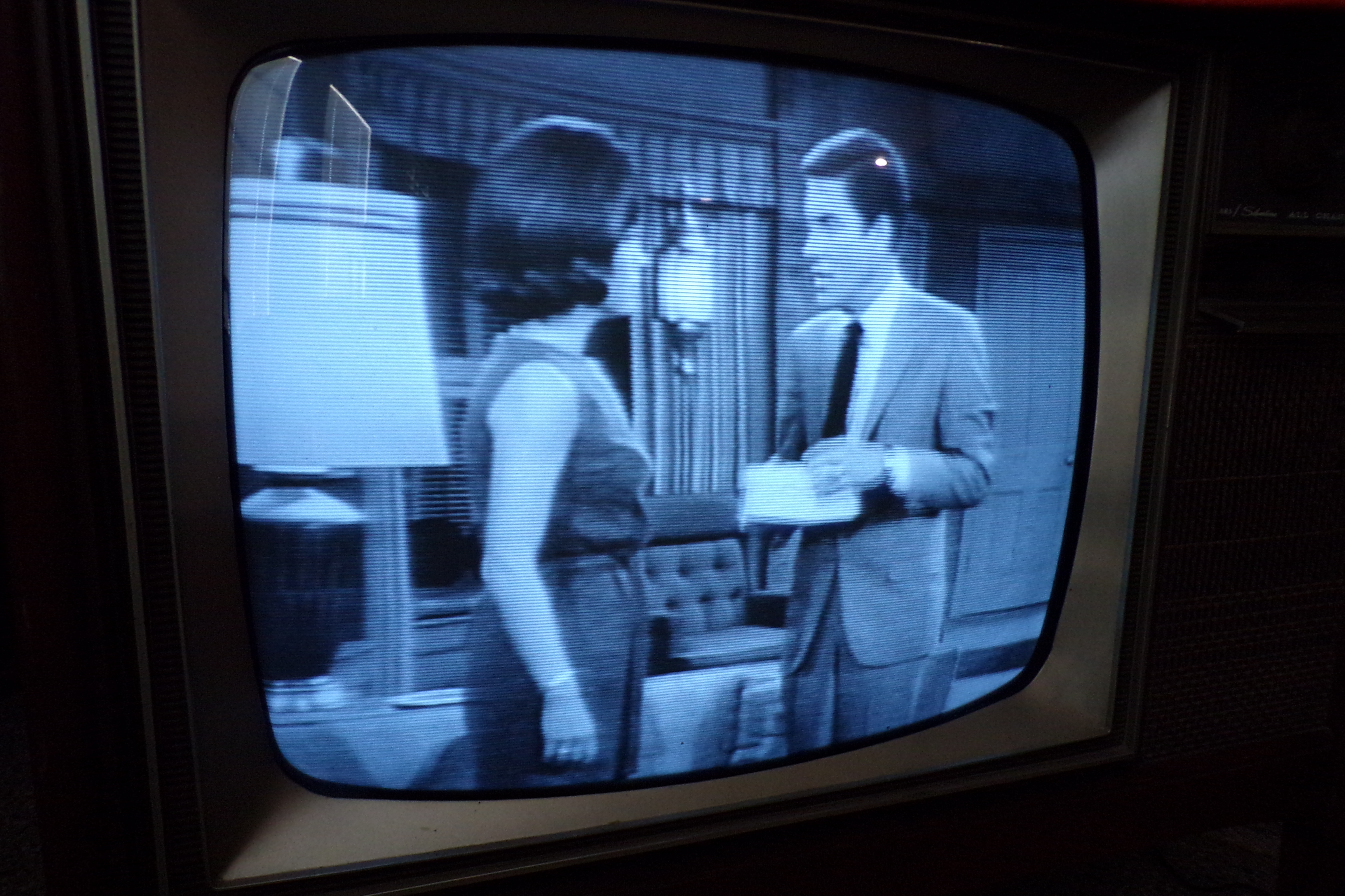

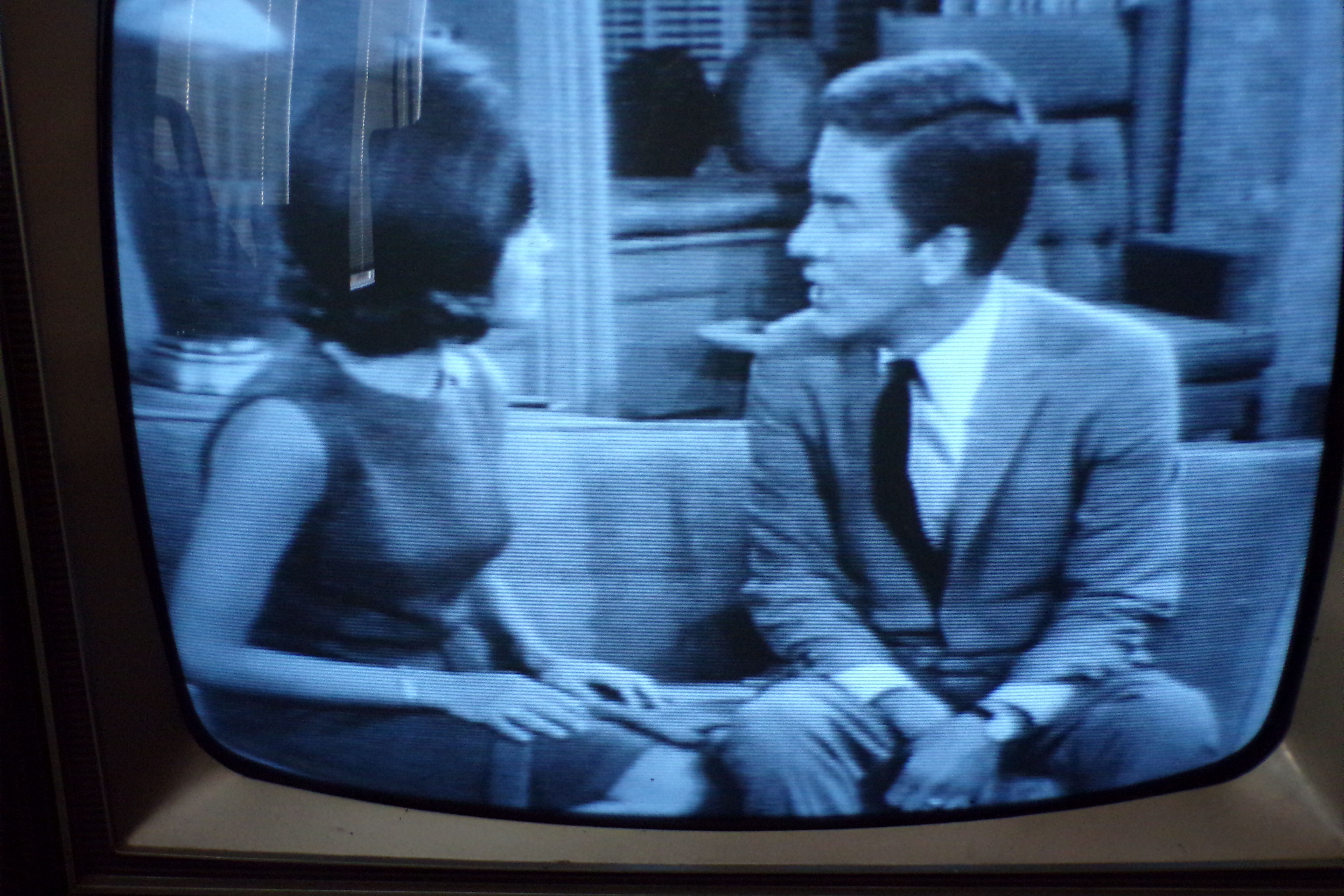

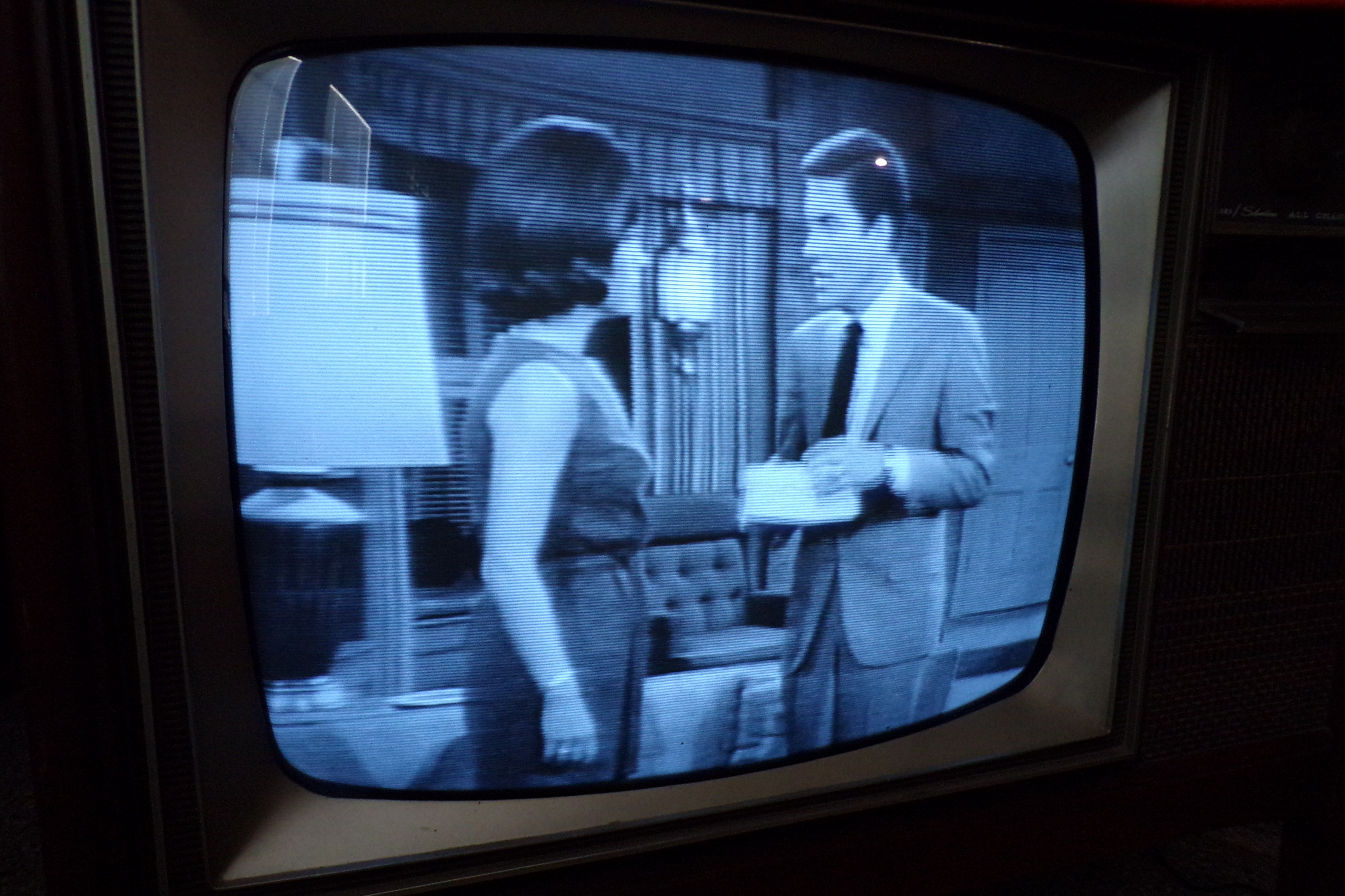

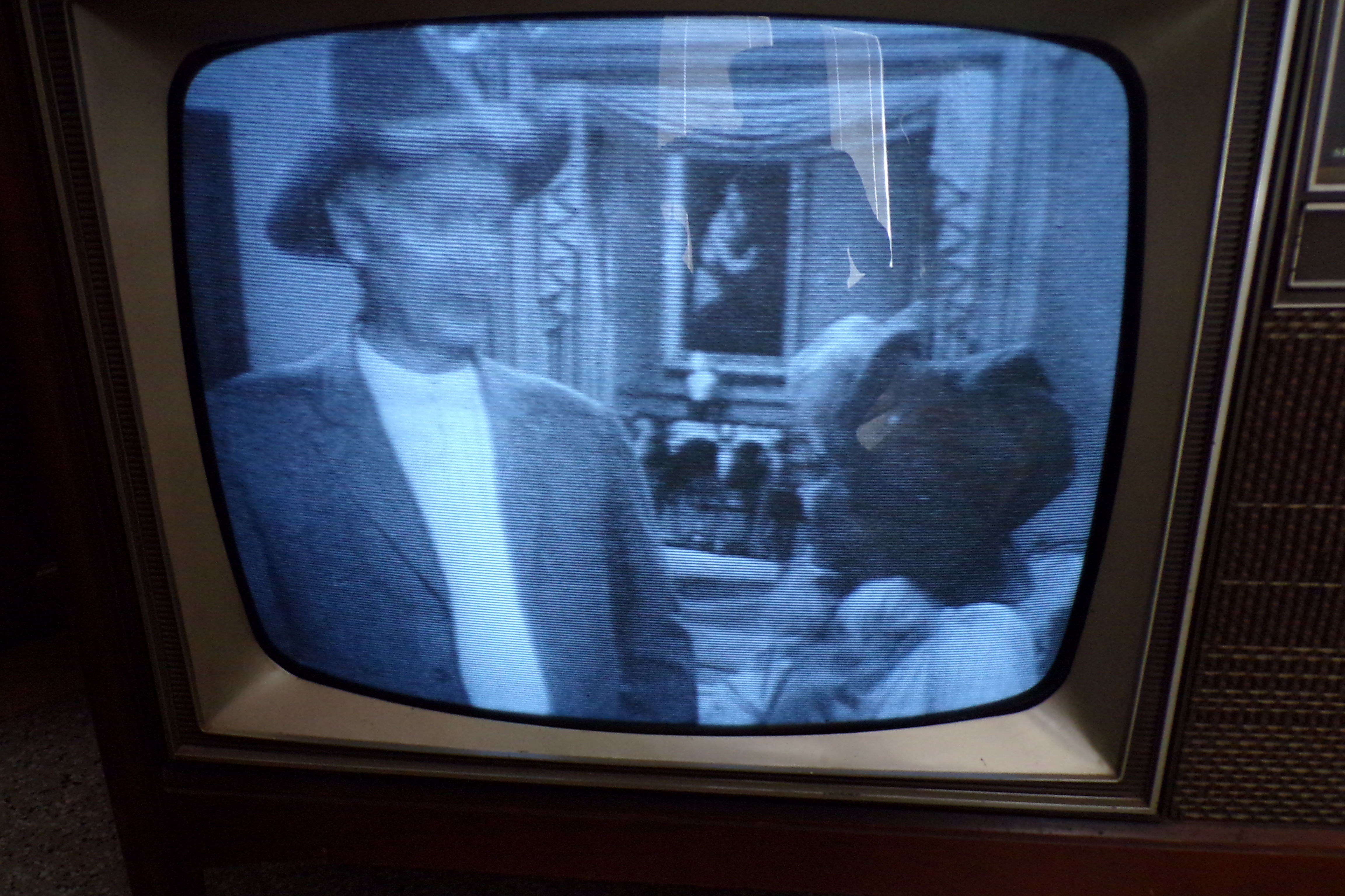

Sorry, no. Sears Silvertone re-used their model numbers more than once. This set is in Sams 786, Folder 3. My guess is somewhere around 1966-1967. The codes I have found are for the 8th week of 1966. IIRC, dad bought this set in 1967. The three-number prefix for the chassis number on mine is 529.
Pictures on power-up. Not too bad, all things considered. Considering I have done NOTHING to this set except dust it and clean the tubes. It needs controls cleaned and some tinkering. It ran a couple hours, filter caps were stone cold. I also confirmed that the Beverly Hillbillies DVD I had been watching was causing some vertical "tearing" collapsing of the raster somewhat vertically, that I was blaming on the TV set when I was working with the RCA chassis. IT was doing the same thing with this Silvertone chassis, one that I absolutely, positively KNOW does not have vertical issues. I changed to a Dick Van Dyke DVD and the tearing disappeared. Now I need to revisit the RCA chassis and see how it performs with the Dick Van Dyke DVD.
