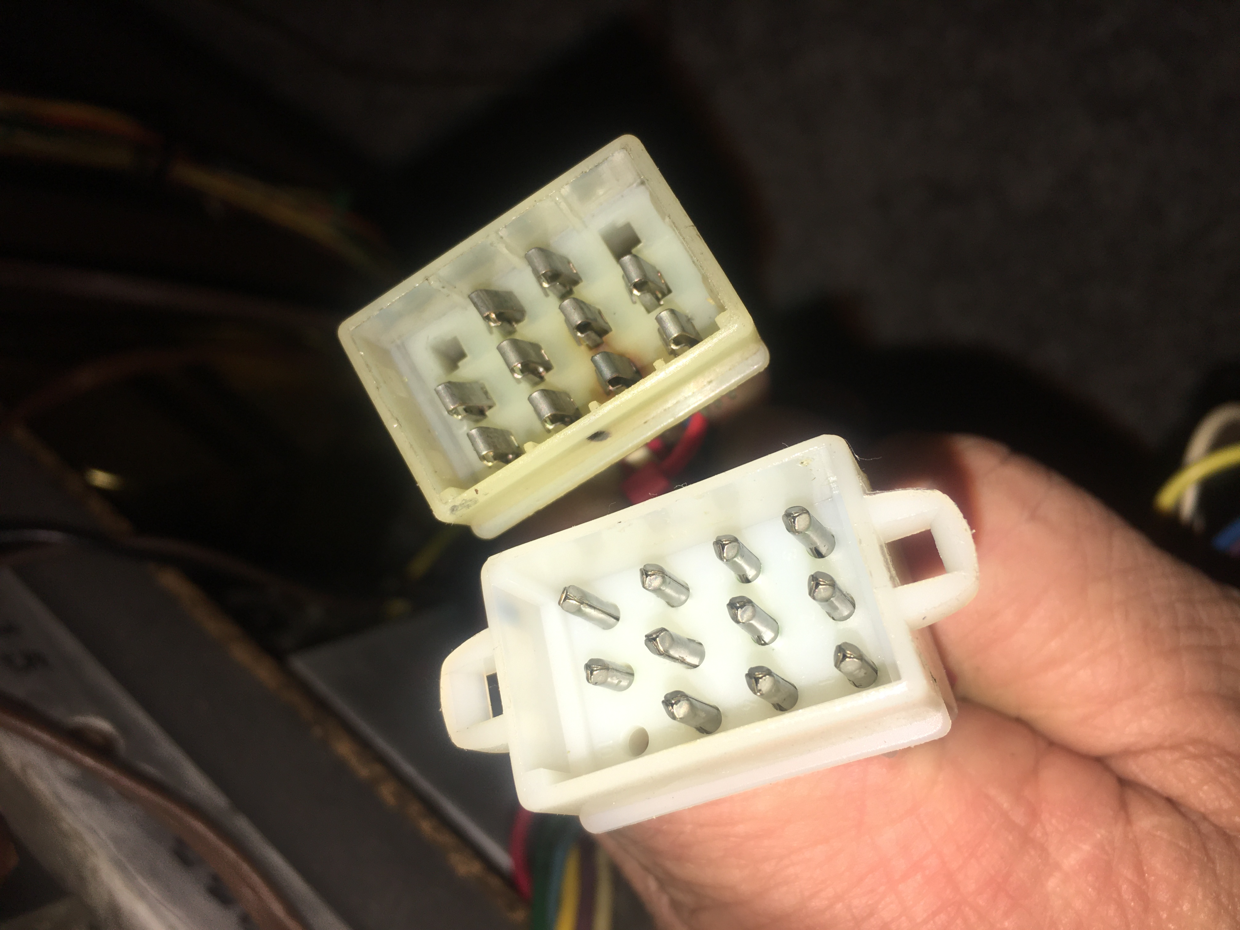

Posts: 362
Re: Strange Molex
Post: # 22530Post Hydrolastic »
Hello guys, So here is a photo of the plugs for the MPX on the CG. The round pin one is the output of the mpx the flat pin is the input to the mpx from the preamp. I can't find the mpx unit that had the different pin connector right now. Idk it could just be a replacement.
Posts: 9024
Re: Strange Molex
Post: # 22531Post electra225 »
All the Molex connectors I am familiar with have flat pins like in the top connector. Perhaps the lower one is a replacement. The Multiplex adapter on my CG is mounted across the opening for the tuner, right above the tuner power supply chassis. I think factory placement is on the back. What a pain that would be to remove the back with the MPX hanging off it, along with the bazillion other speaker and antenna connections.

Re: Strange Molex
Post: # 22546Post eacolaianni »
The Molex connectors on almost all of my Magnavox equipment looks like the one in the top photo from Hydrolastic. I'm also betting that it was proprietary to their tube-type equipment.

Re: Strange Molex
Post: # 22548Post electra225 »
I have a 2ST253 from 1963 that uses the round pins like the lower picture. It also has a differently oriented Molex connector that won't let you use MPX adapters from earlier models. You have to use a proprietary stereo decoder, They even put a plug on the back of the apron of the chassis to plug one in.
