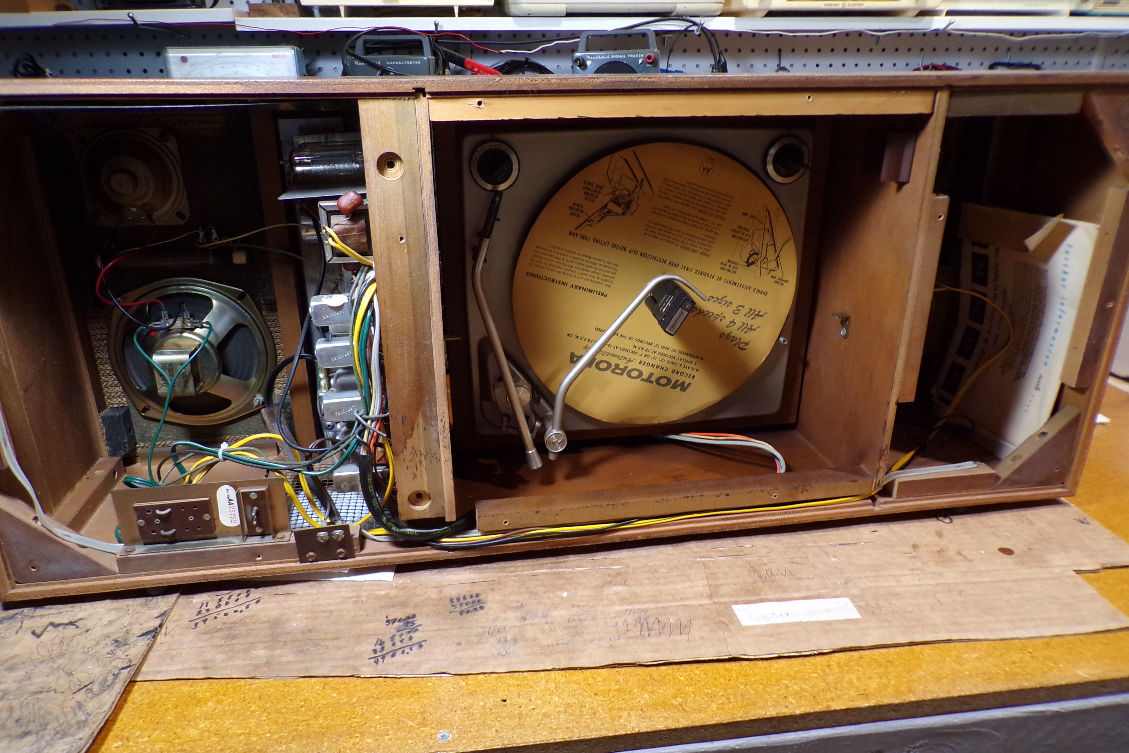

Post: # 12797Post electra225 »
I thought this thing was fixed..... :oops: :roll: :oops:
When it is cold, I have no AM at all, FM is all drifty and comes in and out, with very little volume. After it runs for five minutes or so, AM may work and may not, FM works okay, but no stereo. Another couple minutes, stereo starts working. I suspect a tube, but which one?

The FM side of the tuner will run sometimes all day without quitting. "The Ride" comes in strongly at 94.1, the stereo light comes on, fidelity seems good. AM is another story. It will play from 15 minutes to two hours, then it just fades away over a period of about two minutes. I don't have the chassis out yet, but I had subbed all the tubes from a Motorola table radio with no change. The tubes from the stereo work well in the table radio, so I think I can eliminate tubes as an issue. I was under the assumption that perhaps a tube filament was opening when it got really warm, but apparently that is not the case. The record player will work seemingly forever with no issue.
I believe the first avenue of investigation will be to determine whether the AM oscillator is quitting after a time. I also want to check B+ to see if it's going away for some reason. I think it's fair to say the issue is in the front end somewhere. The function switch is not above suspicion, either. I'll get the chassis out, sub in some test speakers, then connect two or three VTVM's and see what they tell me.

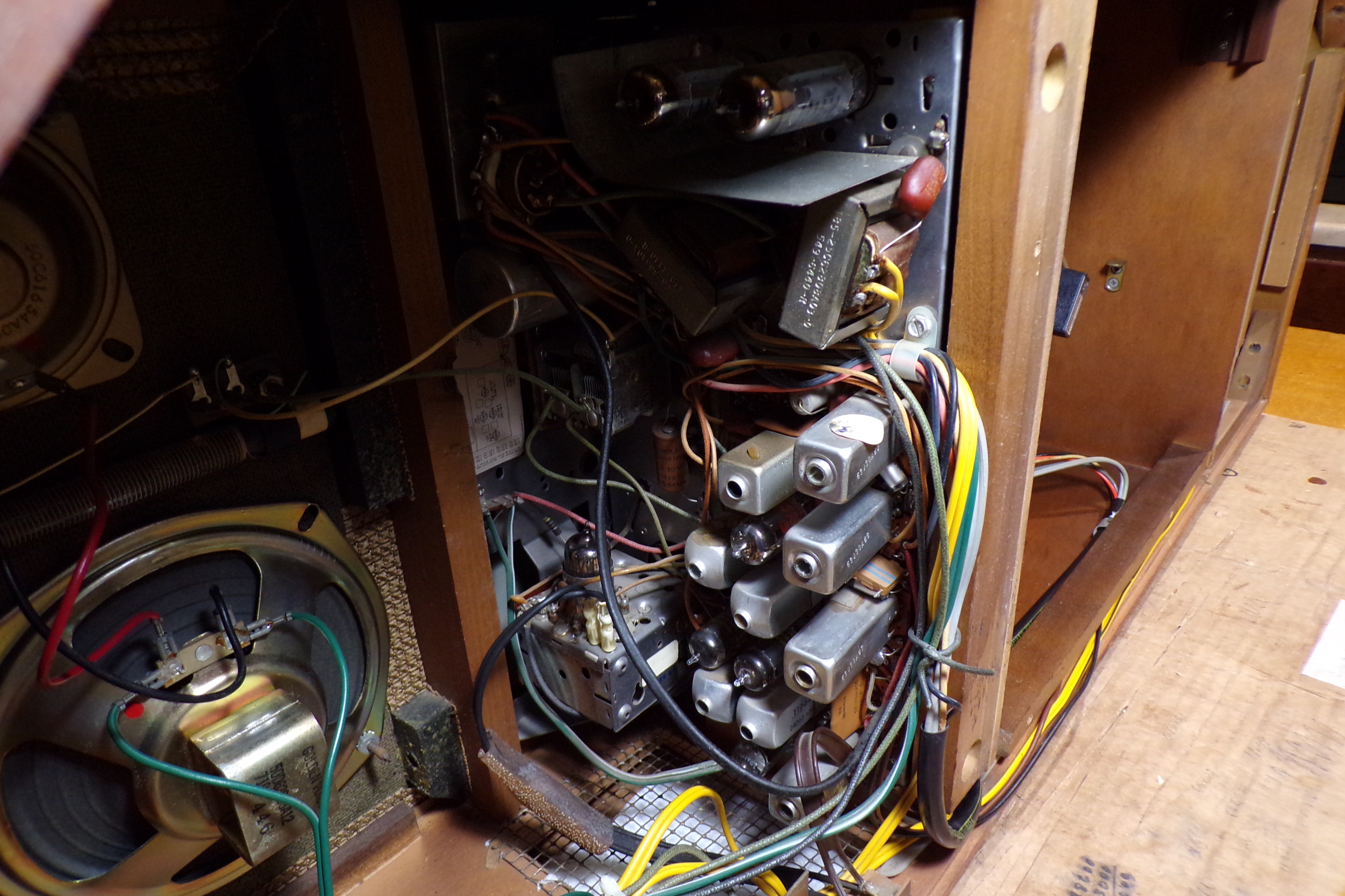

I decided to do with this chassis like I did with the Imperial. I decided to do a component by component check and restoration. The first thing I did was to run the resistance chart that Sams always provides. This chassis is a challenge to work with. The tubes are crammed in so tight among the IF cans that you can't use test sockets. The chassis is PCB, so it is hard to take resistance measurements and get a good connection. The resistances around the 17C9 socket are wildly off. If I hold the function switch just so, the readings are pretty close. Otherwise, some show infinity. Pins 1, 2, and 3 particularly. This brings me back to a wonky function switch. The 17C9 does test bad, one half essentially dead, but that is not the entire problem. Replacing that tube may help, but it won't fix it. Essentially, there is no B+ to the 17C9, which is an RF amp and FM oscillator. I've sprayed enough sauce on this function switch, I don't see how it could still be dirty. I'm beginning to wonder if it is not burnt, or defective in some way. I'll continue with resistance tests. That may give me more evidence on the function switch.

The function switch is oriented so that with the function switch on FM or FM AFC, B+ is killed to the AM-only tubes, mainly the 12BE6. On AM, B+ is killed to the FM only tubes, the 17C9, 12AU6 and the 12BA6. The 12BA6 IF amp tube is shared by both AM and FM. So no B+ to the 12BA6 will kill both bands. When the function switch is in Phono, B+ is killed to the entire front end. This might be nice for the Energy Star rating, but I have been dancing around the trouble by concentrating on AM, since it is the band that is dying. I believe the reason FM is not dying is because the function switch is shorting on AM and puts B+ on FM when it shouldn't. There is a shield over the front (FM and Phono) half of the function switch that is soldered on. That shield will have to be removed so I can get to the function switch better. Most of the resistance readings not concerned with the B+ rail is pretty close. The B+ rail shows infinity on almost every tube in the front end. At least I know what the issue is. Now to figure out a way to remedy it.

I removed the shield on the function switch. I cleaned the switch best I could. It's made a bit different that is commonly seen. The contacts are internal inside plastic. IT's hard to clean the switch. I doused it really well with DeOxit. AM seems to work decently now. I did one alignment. I'll run it a bit then do another. The instructions say to do it sufficiently that no improvement can be made. FM is really weak, which is expected with a dead RF amp. I'll start it up again tomorrow evening to make sure AM still works. The record player sounds good. I'm not ready to pronounce it healed yet....... ;) :cry:
