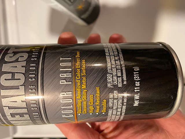

In 2010 I took a gamble and bought some spray cans of what was relatively new (at that time) for the Duplicolor product line.
I put the cans on the shelf and forgot about them for quite some time. Other projects took priority. I finally got around to messing with them again and I wanted to share the results that look quite promising. I don't know how well it would hold up on a frequently handled control panel, but it seems the beat the crap out of regular "spray paint".

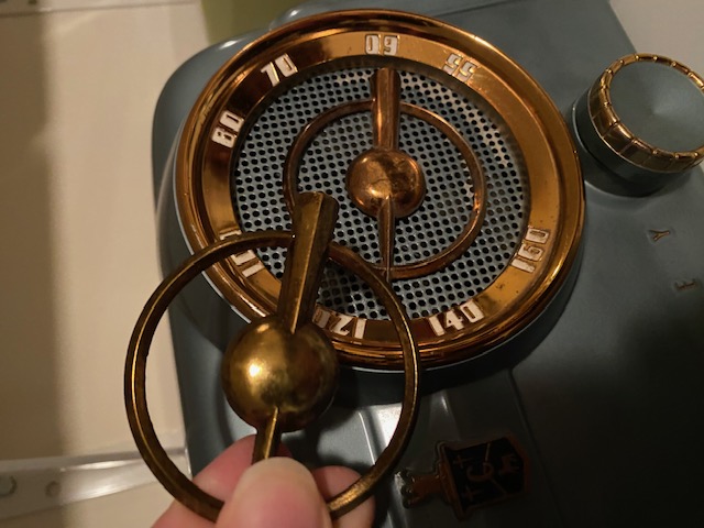

I used a Crosley pointer as practice. Typically you find the Crosley "coloradios" with the gold "worn" off leaving what appears to be chrome. I used some acetone to clean the pointer off thoroughly and then hit it with some yellow Duplicolor Metalcast and then after drying a little bit, hit it with some orange Duplicolor Metalcast to try to "tint" the color. The yellow alone, seemed a bit too "plain" yellow.
Sorry I don't have any before pics. Basically it looked like colorless nickel metal.

The above was just a quick experiment, so the it's not the nicest example. However, the "paint" is transparent so you get an actual reflection of the base metal!
Here's me holding the repaint vs. a factory original survivor.....
Could of used a bit more orange to give it that amber colorant appearance......

I think it is a step in the right direction without having to use special spray equipment.
The only catch is, this stuff stinks to high heck during spraying AND curing. So make sure you have ample personal protection and air flow.
It comes in several colors and marketed towards the custom car crowd, but I think yellow/orange is all "we" would be interested in....

Again, the results may not look that impressive as I just did a quickie spray test on that dial pointer. I didn't even it polish it properly after stripping off the remaining factory lacquer colorant. There was some corrosion on it as well.

I just did a quick Google search for "Duplicolor Metalcast". Looks like it is still available. Is the current stuff still up-to-snuff? I have no idea since my cans are so old. Hopefully they didn't cheat on the formula.

I'm impressed. Looks like it's basically a translucent tinted lacquer, which is what lots of the trim pieces were coated with. Some were brass plated/clear lacquered; some were chrome (etc.) plated and then colored with the tinted lacquer. But this is a solution to the problem.
