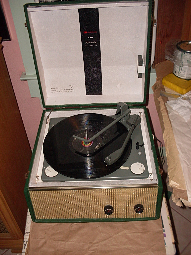

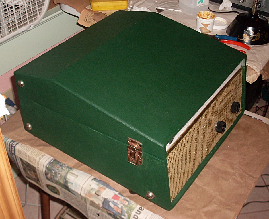

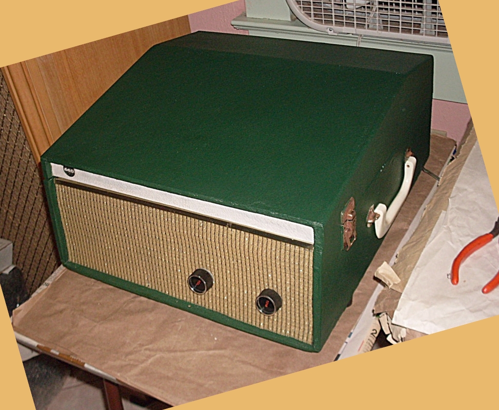

After my own mistakes and its own quirks, I've got
the Bradford finished.
I had some left over speaker grille material and green paint to
redo the finish.
It worked out pretty well.
I cut a vent hole in the underside of the cabinet,
and added some 1 inch tall plastic feet to allow
circulation.
After accidentally breaking the somewhat fragile
plastic tonearm, I epoxied it together.
I used a zip tie around the tonearm to use for a
new anchor for the tonearm mass spring.
I may still find a 25EH5 to see if it will boost the
Pfanstiehl 911 cart I mounted in the tonearm.
It could use a bit more output.

- Posts: 5337
Re: WT Grant Bradford 1-tube Amp Questions
That was a lot of work, but it sure looks good. Nice work!
- Posts: 8910
Nice job! They are more work that you would think before you do the job...
- Posts: 1344
Thanks guys.
Yes, a heckuva lot of time in this, but that's what
happens when you're stubborn and have a vision
of what something can better look like.
