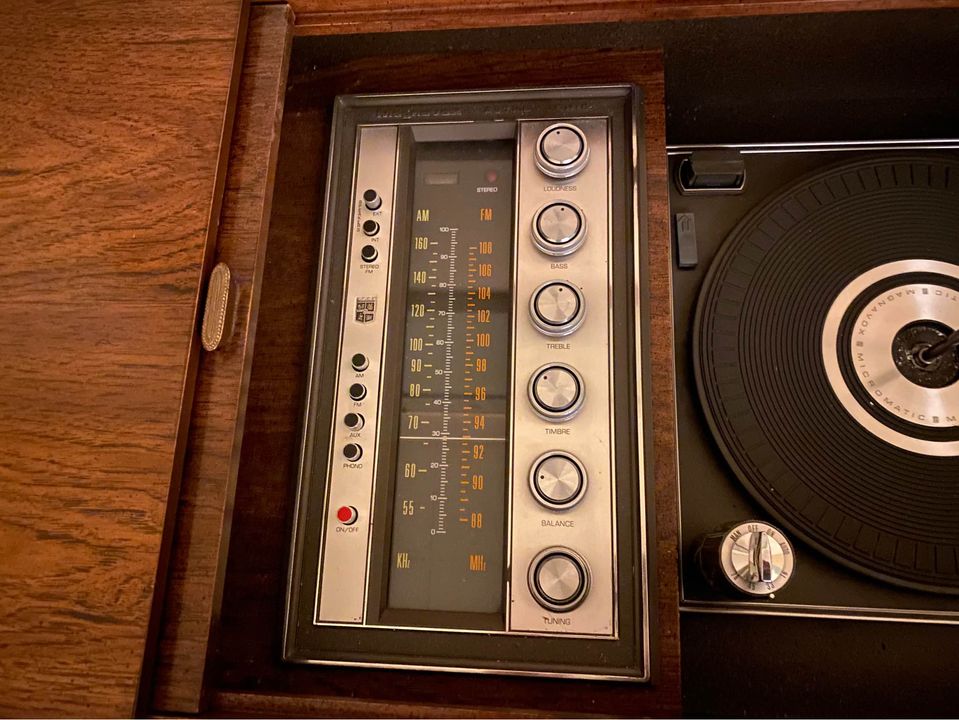

I manage to do simple fixes, I'm okay to replace minor stuff or bad capacitors. I did fix a few old microwave control panels and my 1980 GE electronic toaster oven that got a bad transistor but not too good at finding what's wrong with audio systems. One of my RCA Victor solid state console has a defective FM multiplex circuit and I can't find what's wrong, the other one which is identical (in my avatar with the stereo light on) has an issue with the right channel which is weak when the volume is low and it gets about equal to the left channel when the knob is turned midway and the sound seems to be a bit distorted on that channel. It seems to have less low tones. I have a feeling it's not related to the potentiometer but to some bad electronic components but I don't really know what to check first and how!

The best thing to do would be to get a schematic for them, then start checking voltages. Voltage being off by 10% on tube equipment might still allow it to work. Voltages off by a tenth of a volt on Solid state stuff might be enough to shut the whole thing down. Typically, bulging electrolytic capacitors are the culprit when solid state equipment starts going on the fritz. I have a Pioneer SX-1050 with a dead left channel. I think it is capacitors, but I haven't gotten into it. I haven't gotten into solid state stuff yet, but I'd like to have a go of it some day. We can walk you thru it if you'd like to tackle one or the other of them.
