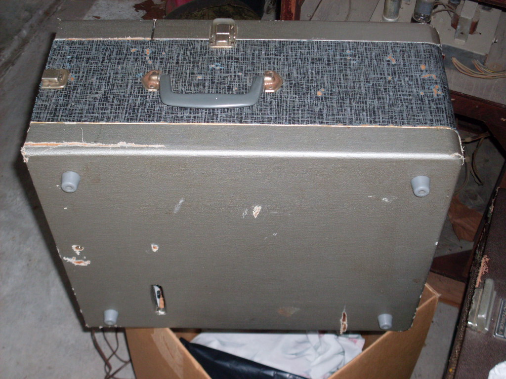

My Magnavox record player has a screw in the bottom, near the middle of the cabinet. It is a screw with a trim washer. That one you posted has a screw, but not the right one, and no trim ring. That looks like a Tolex project. Good luck with the project!

Greg,
I did see that bottom screw, thanks for the mention.
I pulled the tubes: 2 x 50EH5, 1 x 12AX7.
I'm pretty sure this amp is 80-01-00, or 80-02-00.
I'll find out when I start the dis-assembly tomorrow.

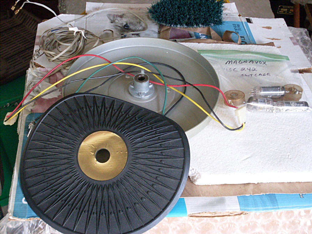

I dove into the Magnavox yesterday, and got the
speaker baffle/amp board off.
The amp chassis looks like a flocked X-mas tree.
Lots of oxidation going on.
The wood screws on the trim bar at the top of the
cabinet were very difficult to remove.
The left front cabinet joint was loose, and I'll have
to look at how to shore it all back up.
The R600 Custom Micromatic mech looks pretty clean.
I was reminded on how difficult it is to reach to the
rear of the cabinet to try to flip up that one last
retainer clip on the back shipping bolt of the changer.
I know she feels better inside with some A/C.
