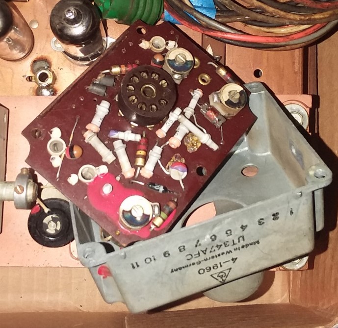

This tuner from a Motorola SK-32 received 1 station that closes the eye tube, a 50 kW modern country station 14 miles away. There is barely any response on other FM locals, due in part to badly drifted gray dogbone caps ranging from 10 pF to 200 pF. Voltages all test spot-on, as well as coils, AFC diode and the resistors. Alignment of IF amplifier transformers and tuner trimmer caps improved things slightly with some other local FM stations making a faint appearance. Still pretty bad for a Motorola and not acceptable for a paying customer. :x
I called a bench tech friend upstate, asking how a Motorola using a 6BQ7 could receive FM even more poorly than a tubed Japanese set, that seems to favor all the wrong frequencies. I never had this issue with a Zenith or Motorola before!
He had an non-functioning RCA version with 12DT8 tube like my 61-62 model RCA's that were just off-frequency. He shot-gunned all the caps and resistors after confirming voltages were correct and coils were OK. Now it works like new after an alignment
After that news, I ordered 12 mica caps for a tiny board pictured below.
Tuner overhaul.jpg (133.94 KiB) Viewed 1501 times
