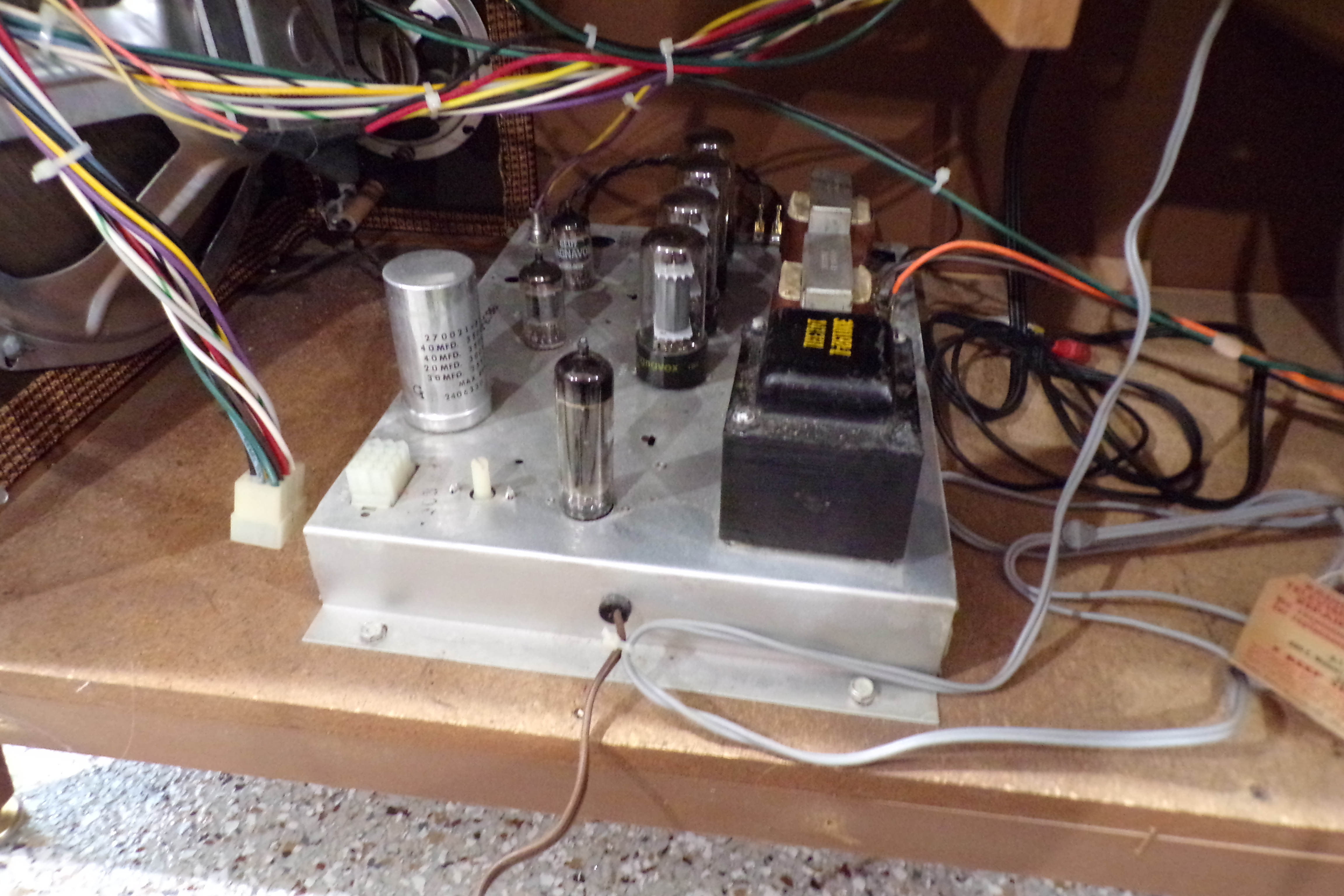

Amp chassis and dangling wiring. The tuner has connections on top of the chassis rather than on the rear apron.

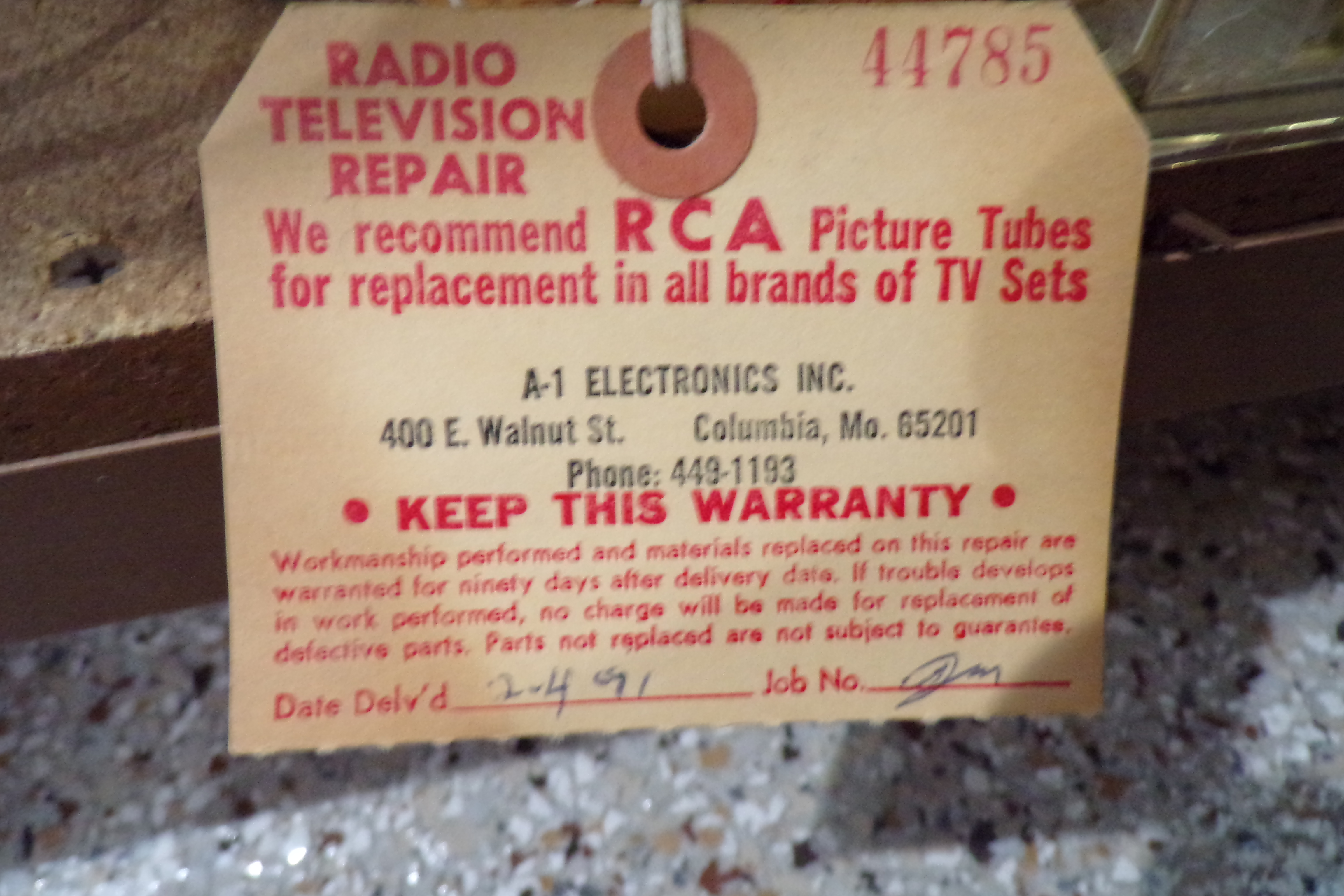

It was fixed in 1971. Wonder what the trouble was?

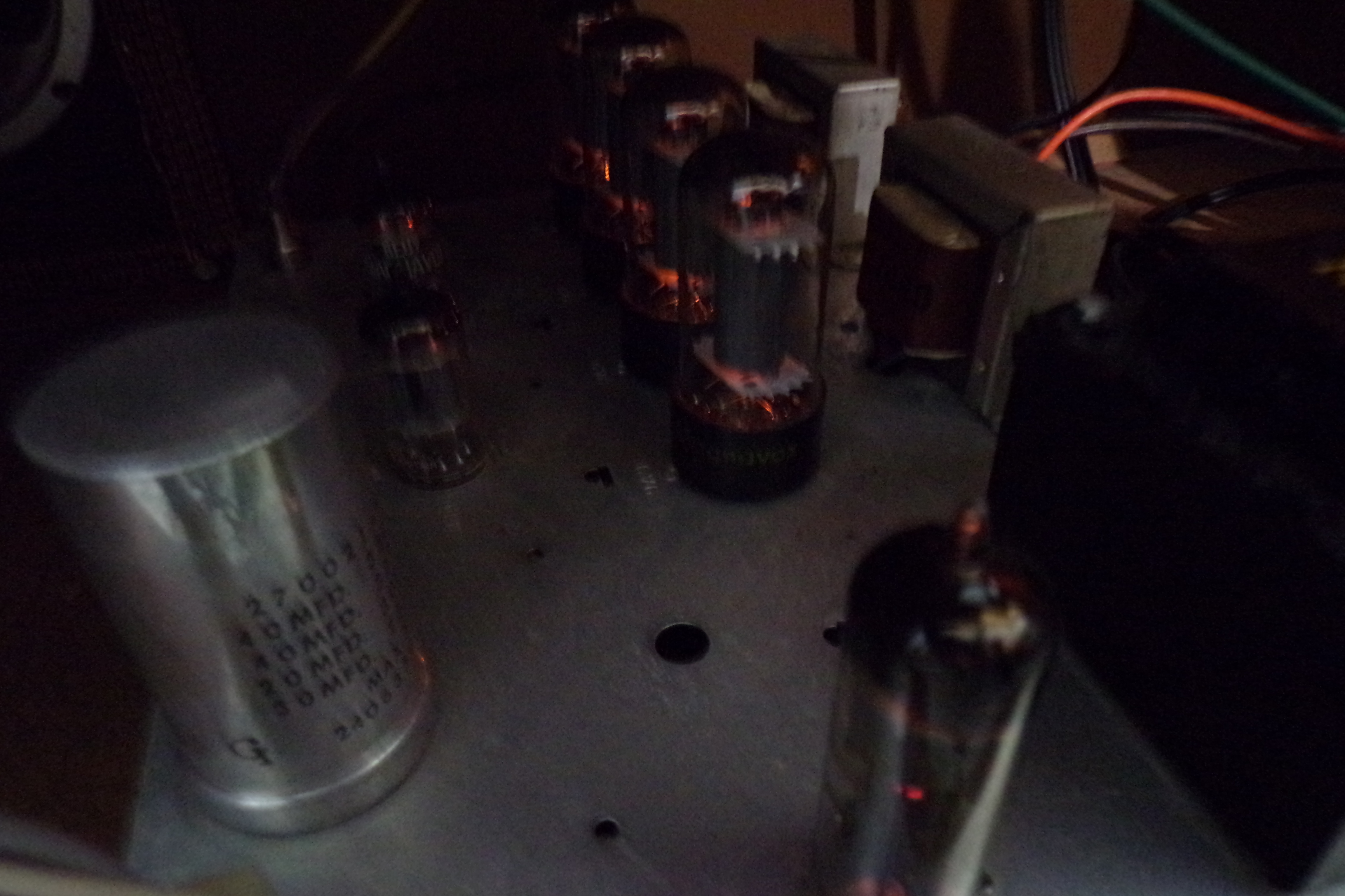

Tubes aglow....

The tubes are marked "Japan" allegedly by Siemens. Dated weeks 23 and 25 of 1963. All the tubes in the amp appear to be factory.
Tubes aglow....

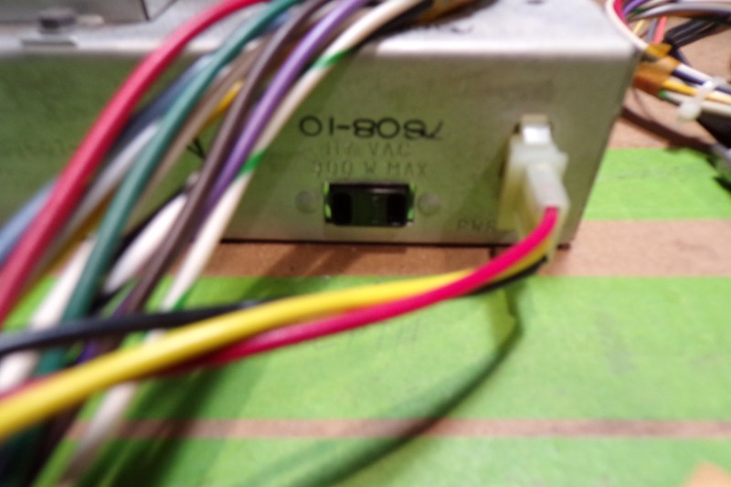

The tuner in this thing has model number 7608-10. I haven't looked yet in Sams to see if they have a schematic for it. I need to know if this is wired like the older models. If it is, I'll change the Molex connectors so I can use a MPX adapter. If it's not, this stereo won't get stereo FM capability. I hadn't planned to get this deep into this stereo at this time, but here I am again, another job out of sequence.

The model 7608-10 tuner in this little stereo is different from any tuner I have worked with dealing with Magnavox. The design and workings are basically the same as the other "Series 100" tuners, but the connections are completely different. I discovered something else even more interesting. There is an outlet on the rear apron of the tuner chassis, a line-voltage outlet. I don't know yet whether it is switched, but I'm guessing it is. If this outlet is switched, that may be the answer for installing a Multiplex adapter with a minimum of fuss. Just obtain an aftermarket Multiplex adapter and use it. I won't have to rewire Molex connectors or any of that. Seeing that outlet causes me to wonder if Magnavox built Multiplex adapters specific to this tuner. They may have intended using aftermarket units rather than having to come up with one specifically for this one-year only tuner chassis. The only other Magnavox tuner chassis I have with a power outlet on it is the Stereo Theater, used to power up the TV chassis.

Power outlet on rear apron of the tuner chassis to power a Multiplex adapter, switched.
