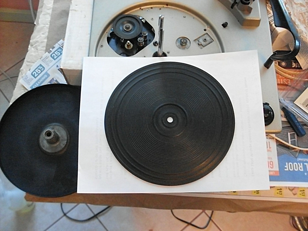

I'm nearing completion of the V-M 959 changer
on the Philco.
The mat was extremely scuffed, and a thorough cleaning
made no difference in appearance.
I put on the old thinkin' cap, and "art supply" came
to mind.
I then remembered using that cool old Scripto
glass ink-well in school.
I checked in at our long-lived art supply for "inks".
I found this Higgins Permanent black ink for about $5.
It's used for calligraphy and the such.
Should dry flat, so what the heck, I'll try it.
Worked like a charm. I used a small art brush to apply
and wiped off excess with a cotton rag.
Sun-dried and the mat has good grip.
Before and after pics.
Philco Record Player1.jpg (201.62 KiB) Viewed 3288 times
Posts: 3690
Re: 1957 Philco Tabletop Player
Post: # 12031Post TC Chris »
Great idea. And the ink is probably water-based so it would not deteriorate the rubber.
Posts: 5340
Post: # 12036Post William »
Nice job, now I hope I can remember that when I need to freshen up a mat.
Post: # 12037Post Firedome »
Brilliant idea, good to know.
