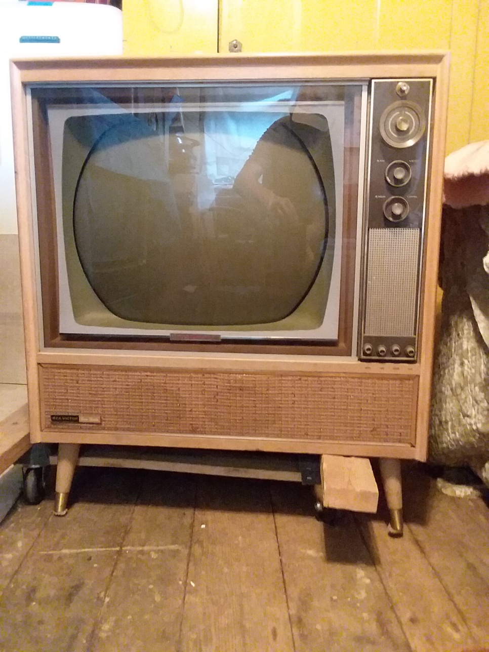

I do have one, it was my Grandparents on my Mom's side. It's called the Brandywine, it's in a maple cabinet and I'm listening to Christmas records on it as I write this. For those that are following this thread check out a thread that Dave, Motorola Minion, posted awhile back. It's about 4-5 back and it's titled "Brandywine". It shows what mine looks like. I have the brochure; it was listed as next to the TOTL. The TV chassis were the same, the difference was in the stereo with the TOTL having more power and different speakers. TV remote was available on all of the deluxe Mark 1 chassis.

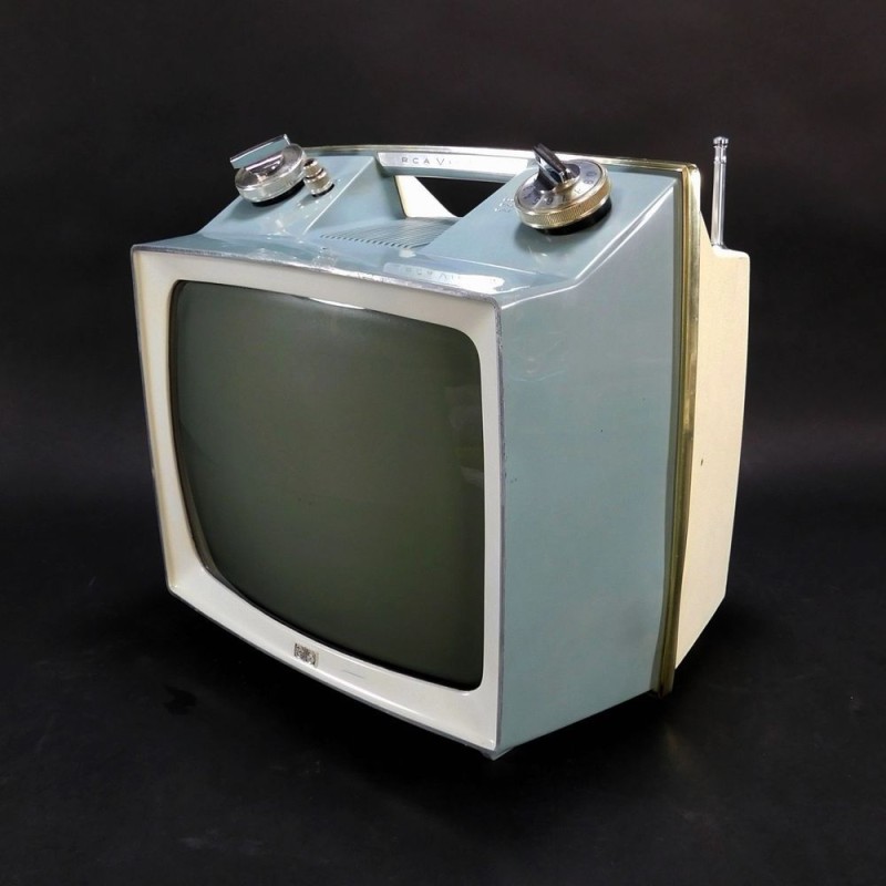

KCS 152 (?) - first all-transistor portable 1966, and very easy to repair if it even needs it. pic below KCS 171 was a 19" portable that was popular in 1970 due to price mainly.
