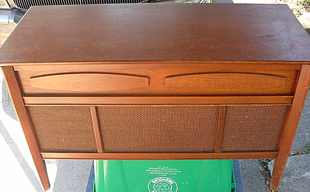

1966 Catalina 122-784A from White Stores

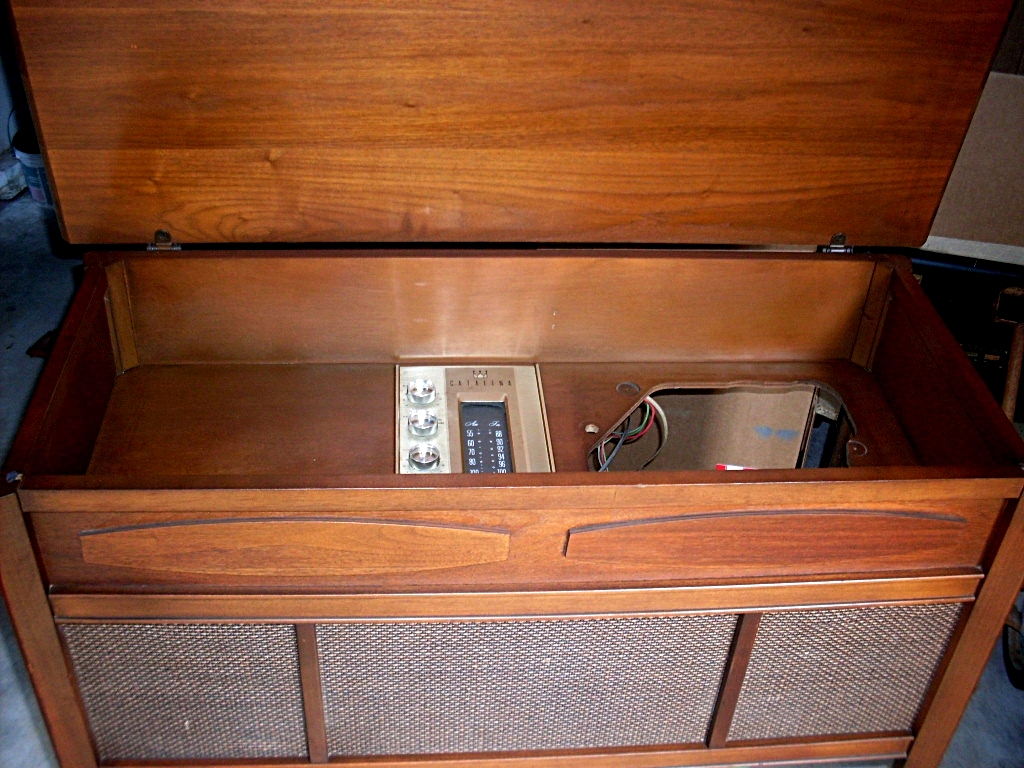

Ms. Catalina arrived yesterday for restoration.
The young family is stoked to have it playing.
It's an all tube AM/FM/FM Stereo/Phono with solid wood
and 3/4 inch plywood making up the cabinet.
It has a V-M 1297 stereo changer with a nice Astatic 718/Euphonics
stereo cartridge. I just happen to have a new stylus for it.
Two way speaker system: 6 inch woofers and 3.5 inch
tweeters with capacitor cross-over.
Output tubes are 50C5, one for each channel.
I'll be curious to see how it sounds with these
low power tubes.

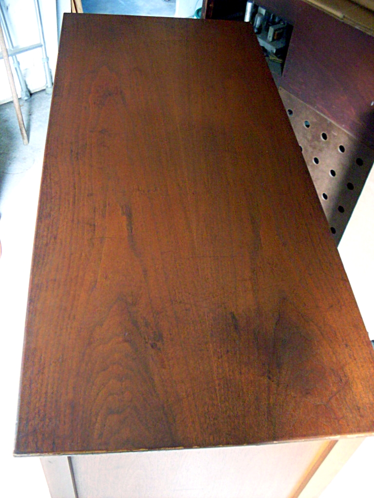

I went over the cabinet yesterday, and it cleaned up
well and looks nice after the Howards Walnut and 0000 steel wool.
Inside the cabinet, I found a jukebox strip and a MilkBone(R) dog biscuit as
bonuses !

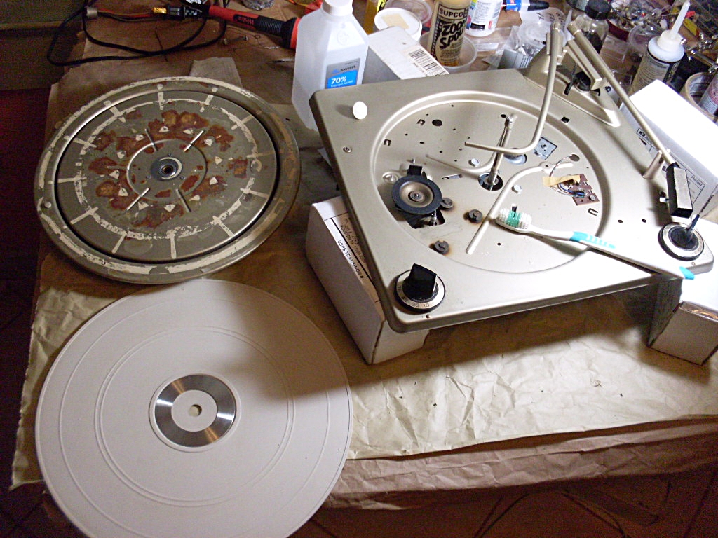

Last night I pulled the platter off, and cleaned the mat.
I was pleasantly surprised how nice the mat came out.
I'll clean off some of the old glue on the platter and mat.
Will re-glue the mat with Elmer's wood glue.
Today, organize the work table and start the dis-assembly
of the V-M changer.
I hope the plastic On/Off switch is not broken. At this age,
that is not uncommon.
low power tubes.

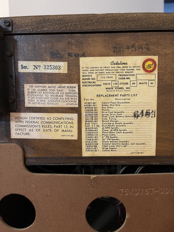

Do you have any idea who manufactured this stereo, Mr. Mogul? They should have lots of fun with it. It's a cute little stereo.
Re: 1966 Catalina 122-784A from White Stores
Greg, From my perusing the web, it appears thatelectra225 wrote: ↑Mon Oct 17, 2022 2:00 am Do you have any idea who manufactured this stereo, Mr. Mogul? They should have lots of fun with it. It's a cute little stereo.
Wells-Gardner made the chassis.
Apparently they did this for numerous sales outlets way back when.
https://antiqueradios.com/forums/viewtopic.php?t=387057

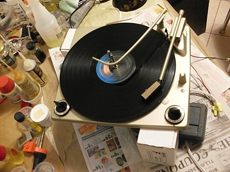

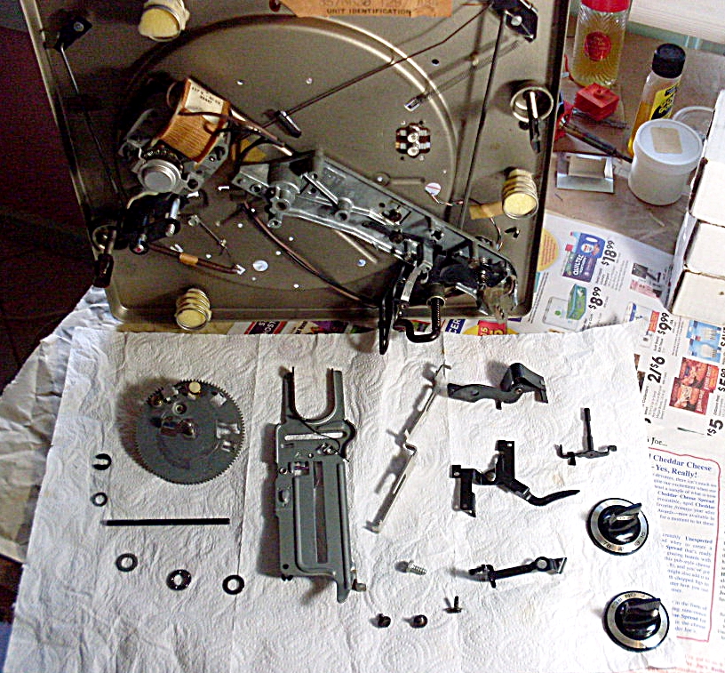

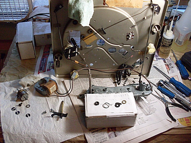

I've got the console's V-M 1297 changer dis-assembled,
cleaned and will lube.
I'll put it back together tomorrow for a manual run.
The plastic switch feels OK, so far.
King's X crossed for luck it won't break.
The idler was hard as ceramic, but I've got
a new one here from Gary at V of M.

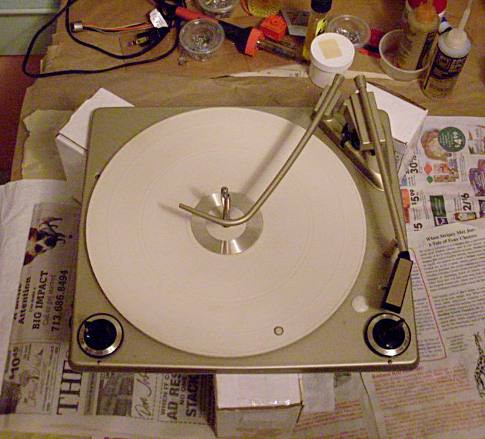

The V-M 1297 is all back together.
I had a "wth" moment when first testing
it and the tonearm would not clear
its rest post.
The tonearm height adjusting screw on these is real
different than the early 1200's.
Instead of backing out the screw, you have to
turn it clockwise, which pushes a riveted tang
outwards. This then allows the tonearm to lift
higher when the tonearm lift pin engages the
tang.
I put in a new idler, the motor mounts were fine,
and I have the stylus for the Astatic cartridge.
Surprisingly good, I did not have to adjust the
tonearm end of record pickup function. Hurrah!
its rest post.
tang.
