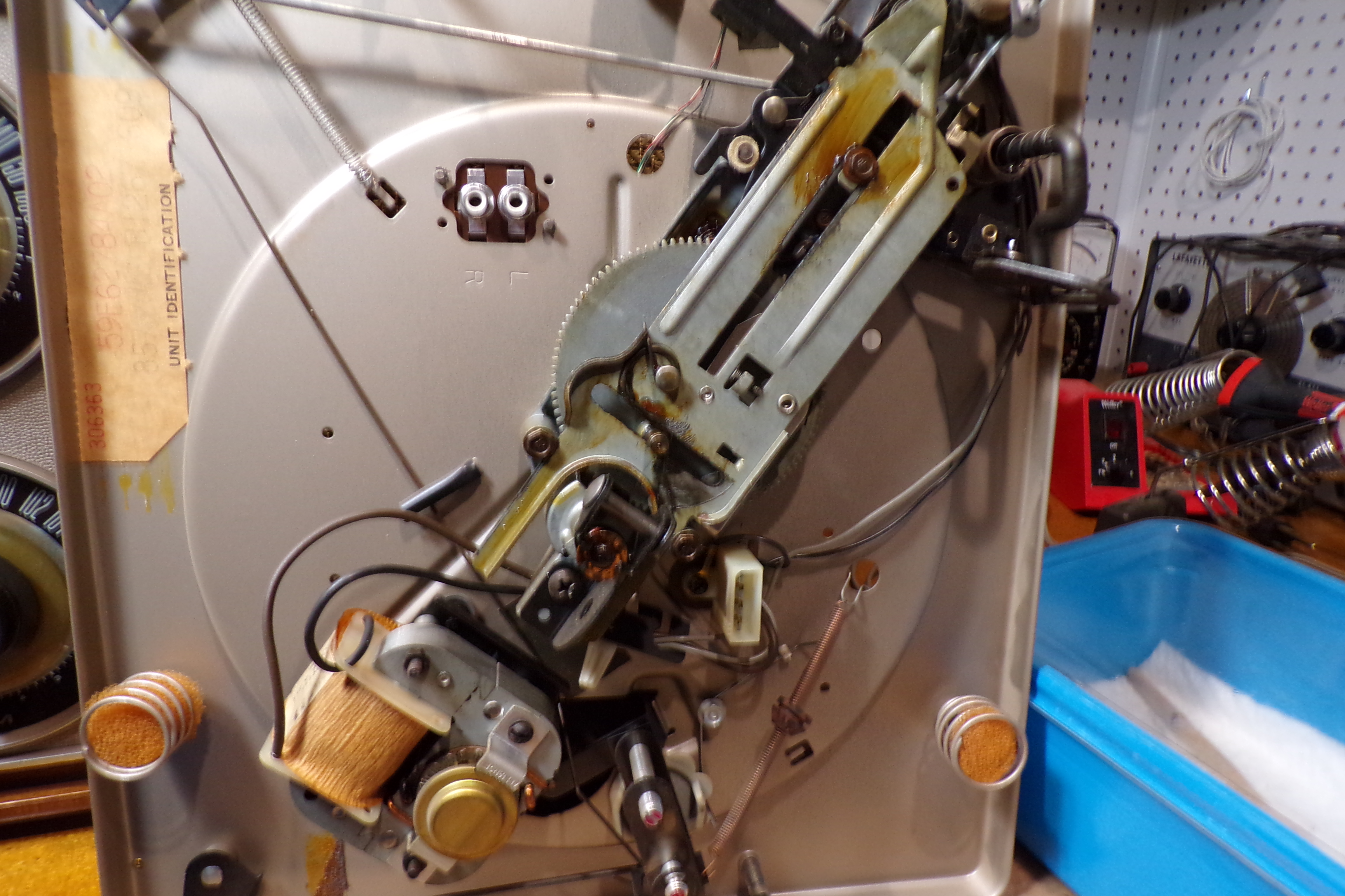

I have some pictures of the changer. VM model 1267.

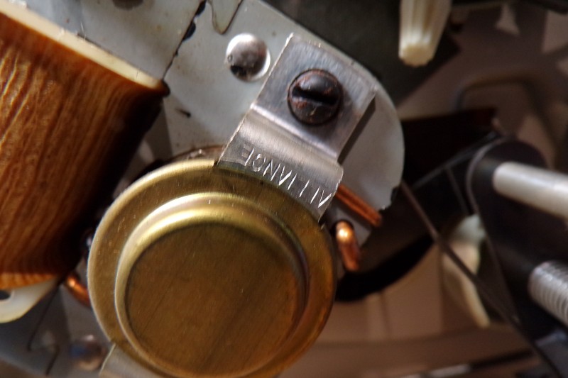

Motorola uses an Alliance motor. The GE's I have use a GI motor on their VM changers. Moto must has spec'd a better motor?

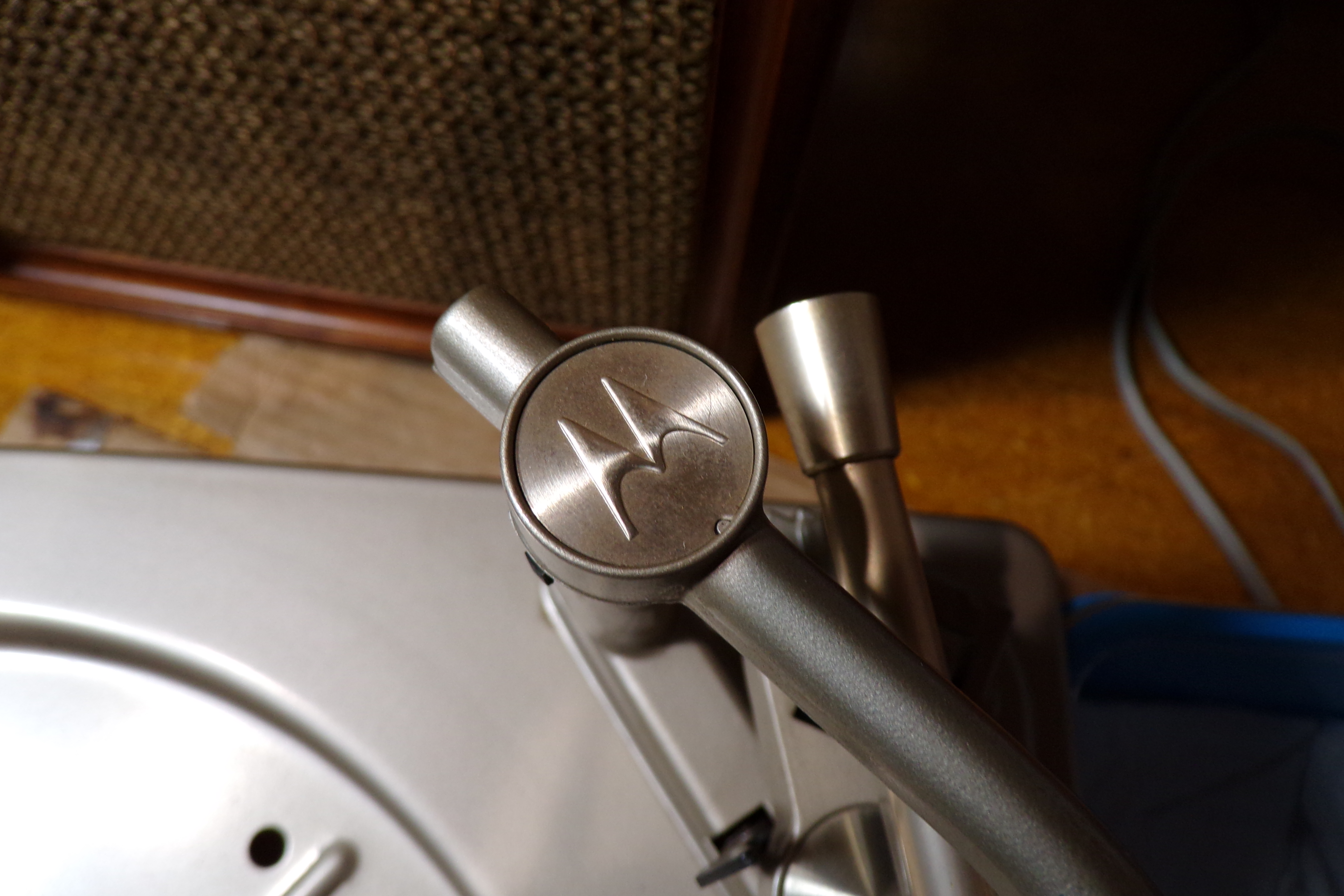

This is allegedly a Tetrac cartridge. Perhaps some of the cartridge gurus on here could straighten my thinking on this.
I found the box with the new needle. In that box, was a set of new motor mounts, so that worked out nicely. This is a really clean changer, I believe with low hours. The motor bearings were still nice and shiny. I gave it a good cleaning and lube, put it back together. The drive tire was still pliable, so I gave it a good cleaning and a light sanding.

1. Yes that is a Tetrad cartridge, a special narrow
design for that particular Moto tonearm.
I've seen that tonearm in a few Moto consoles of same era.
If the cart ever fails, Gary at the V of Music has a way to
install another Tetrad. The original Tetrad is
no longer obtainable.

There is a little plastic bolt/screw under the tone arm that apparently adjusts how high the tone arm lifts. I gave it a quarter turn. It doesn't take much to make a lot of difference. It seems better the more records that get stacked on the spindle. I don't know how many the limit is, but I stacked six and didn't have any trouble. I have the service instructions for VM changers that I consulted to see what I needed to do. Taking the mechanism apart is out of my wheelhouse at this point. Maybe sometime down the road. I'm learning in baby steps how to work on changers. There was a time in the not-too-distant past I wouldn't have attempted even this much. I appreciate everybody giving me the benefit of their knowledge on changers.
I gave the mechanism a "shower with your socks on" kind of clean and re-lube.
